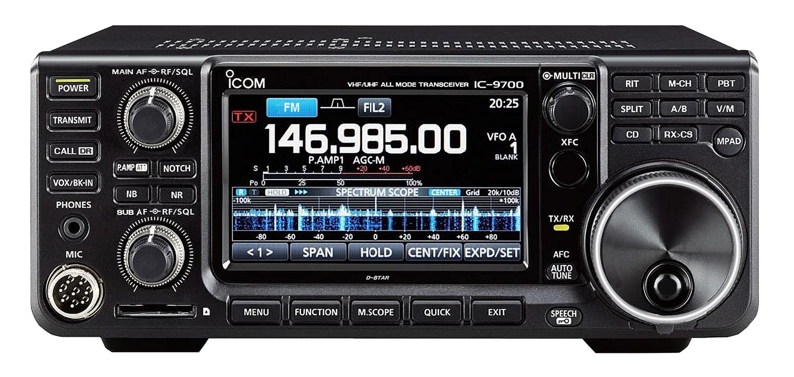

Using the new Icom IC-9700 in D-Star DV Internal Terminal mode and connecting to the multi-protocol XLX122 B reflector. Radio is running the latest firmware as of June 29, 2019 ver 1.11
The IC-9700 is a very feature rich radio. One feature it has is the ability to make pure IP connections via the built-in ethernet port and connecting to gateways running G3 software from Icom and/or reflectors running “open software”. This is a short guide on connecting to an open reflector XLX130 B.
