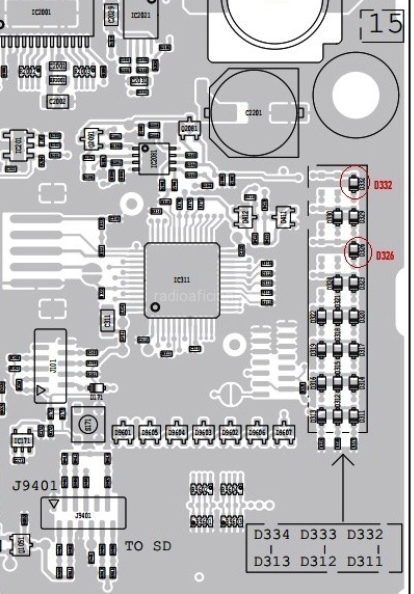

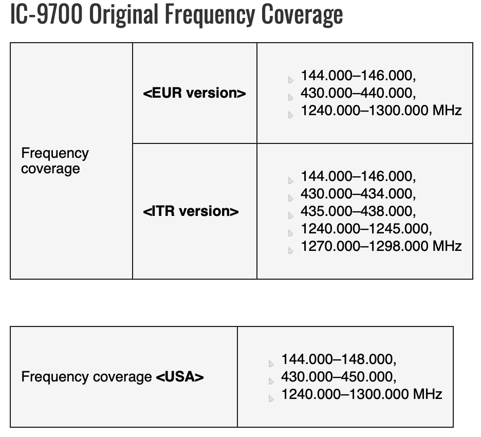

The modification only works on European models and by removing 2 diodes the frequency can be expanded by a few MHz to the USA
That means 2 MHz extra from 146-148 MHz (which is a welcome modification for UK users since they have temporarily access to 146-147 MHz) and extension from 440-450 MHz.

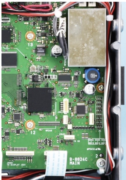

No wideband or MARS/CAP modification available yet. I guess the diodes can be found in the front.

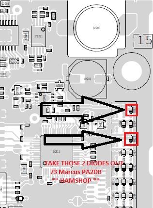

Removing 2 diodes: D332 and D326
