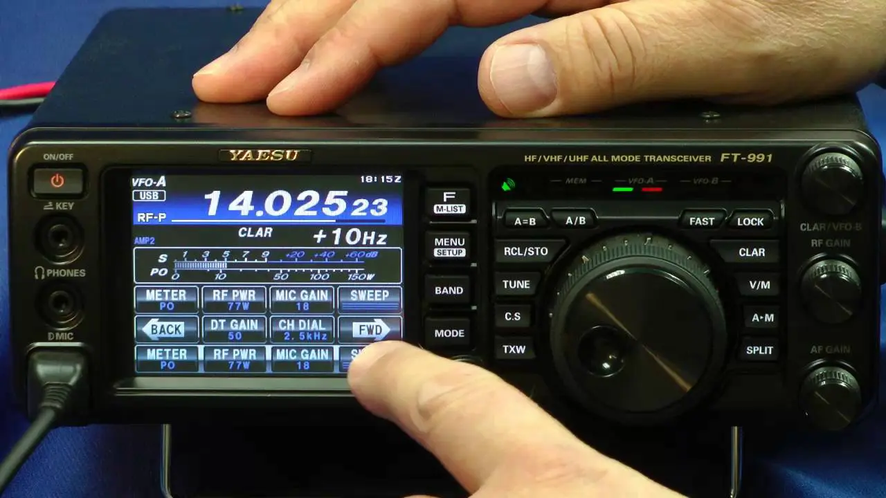

There are a few adjustments you can make to the Menu settings and Functions, along with “hard” adjustments to the knobs on the front of the FT-991A that will improve your SSB Signal Receives.

Setting Summary
 – In order shown in video…
Menu Settings
001: 300 mS*
002: 700 mS*
003: 3000 mS*
* Factory Defaults – Recommend Keeping
023: 2 mS
024: 30 dB
025: 5
Ragchew
102: 100 Hz
103: 6 dB/oct
104: 3000 Hz
105: 6 dB/oct
Heavy traffic (Contest, DX Pile-up, etc.)
102: 400Hz
103: 18 dB/oct
104: 2400 Hz
105: 18 dB/oct
112: -15
113: 10
114: Wide
115-118: Adjust for preferred display
Function Menu:
NAR/WIDE: WIDE
NB: OFF
AGC: AUTO
ATT: OFF
IPO: AMP 1 (ADJUST TO CONDX)
NOTCH: OFF if not needed
CONT:  OFF
DNR:  OFF
DNF:  OFF
SHIFT: AS REQUIRED
WIDTH: AS REQUIRED
KNOBS (AF GAIN, RF GAIN, CLARIFIER) AS REQUIRED
